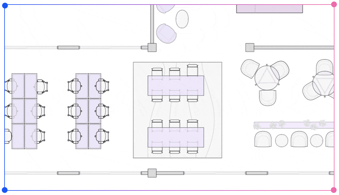

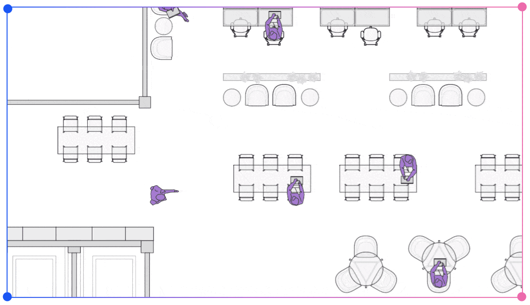

#01 Offer a Variety of Workspace Stations
The new office is one where sitting at a desk is optional. For that reason:
  • Make sure you are integrating flexible “hot desks by demand, alongside a permanent desk area, with both sitting and standing options.
  • Allow various seating arrangements for working: high, low, single and group seating. This way, every employee can have a customized experience tailored to their needs.

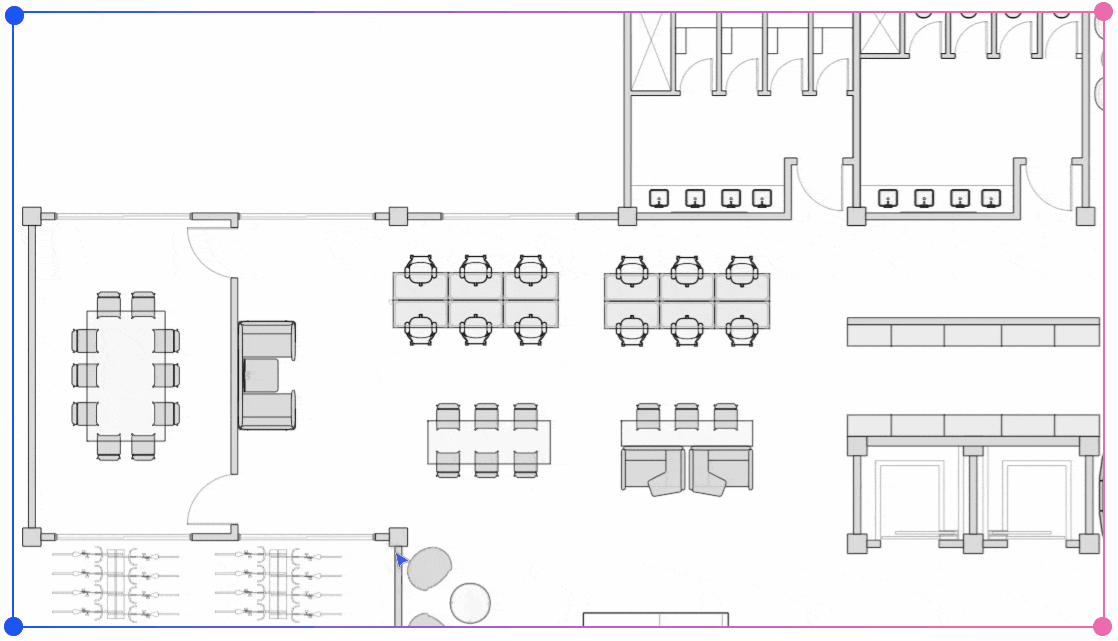

#02 Provide Privacy within the Open Space
An open space layout is ideal for maintaining flexibility in an office or co-working space. Nevertheless, some basic conditions for being efficient can be damaged in this design typology. To mitigate that:
  • Offer designated areas for workers that need calm and privacy to focus or hold talks without interrupting their colleagues.
  • Embed acoustic private booths and areas that give an alternative to the open environment buzz.

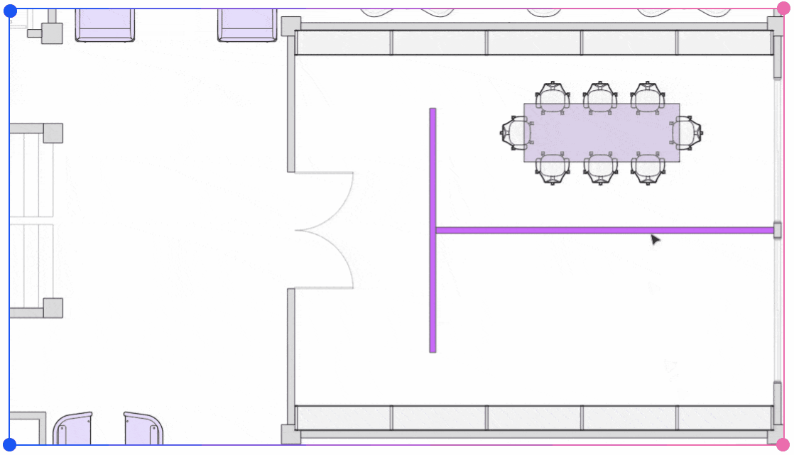

#03 Maximize the Meeting Room Space
Say goodbye to formal meeting rooms that remain empty for most of the day.
Treat a room as a place full of possibilities, by incorporating modular division wall panels in it. This allows adjusting the space to the specific activity and number of people participating. Whether it is a meeting, workshop, company gathering… even a morning yoga class for employees — your space can handle them all.

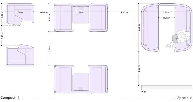

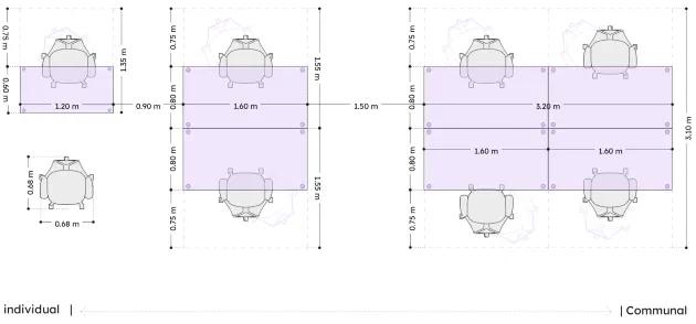

#05 Bonus Tip: Useful Dimensions & Resources
Maintaining balanced proportions in a space is crucial, whether it is big or small. You might be wondering about ideal dimensions of furniture and circulation in office spaces that make sense in your specific layout.
Here are a few useful dimensions that might come in handy. Also, if you are looking for 2D models like the ones in these schemes, you can find them right here.
Workstation & Circulation Dimensions
Private seating & Circulation Dimensions
